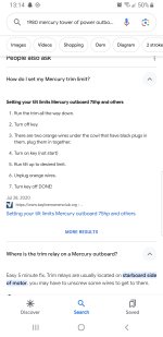

Aug 13, 2023
2
Those wires might be for setting your max down travel. I seen it while researching my own issues. not sure of what unit it was but they said.
1 key on and lower unit to max
2 key off, join wires
3 key on, raise motor to desired max down travel
4 key off, disconnect wires and max down travel should be set
I am not any kind of expert on this and have never tried it myself. Just something I remember seeing somewhere.

Found the info I had seen. See attachment.
