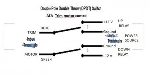

green and blue motor works both ways so Voltage/current must be presented in alternate directions ..up or down
since the motor can trim UP ok then both wires from the relays are ok and do pass juice to the motor because one wire has 12v and the other is grounded.
In the reverse order DOWN no power appears on the GREEN wire presumably tested between the green wire and engine body. By the way while you test for 12v also test the other wire (blue) for it's ground since the motor needs both ground and 12v from the relay .
if the green can carry the necessary ground for the UP operation the wire is physically good and the relay isn't doing it's job of flipping Green to +12v .
option 1- relay contacts defective swap relays if good buy a relay
option 2- + 12v is not reaching the upper contact of the bottom relay in the above picture .... find the +12v

see pict.
in the non operating mode both blue and green are grounded with either wire waiting for the other to flip to +12V thus reversing current flow to the trim motor
