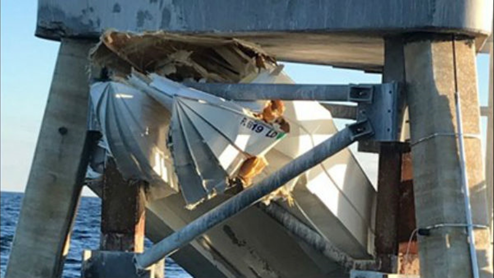

depends on the size of the boat.
I was referring to the ICW markers.
however the markers you posted in post #4 usually will take out the hull of most recreational boats.
