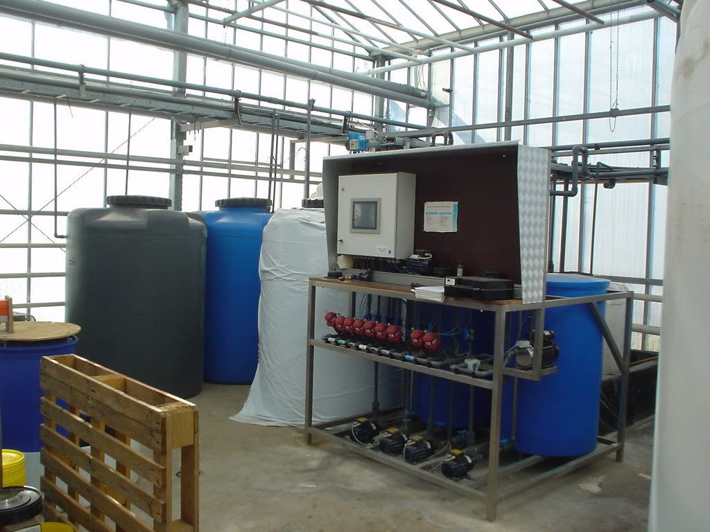

This is the fruitaliser unit with computer.

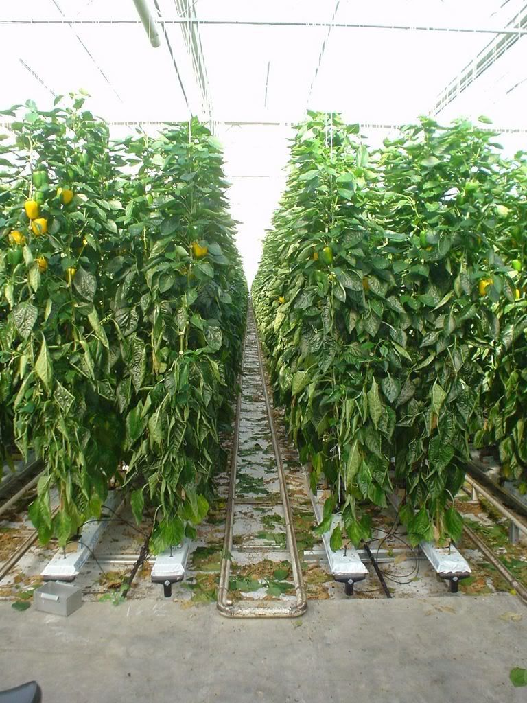

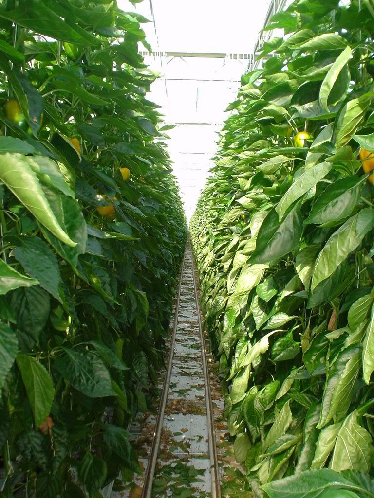

This is the pathway were you can see the tube railways.

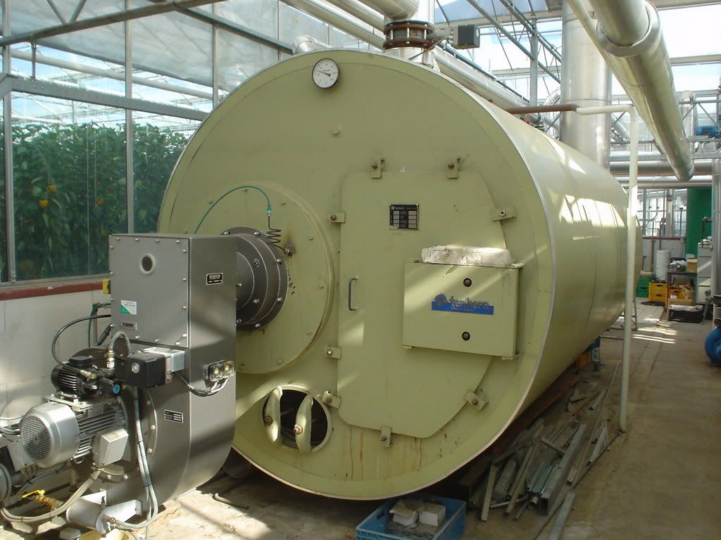

This is the heater.

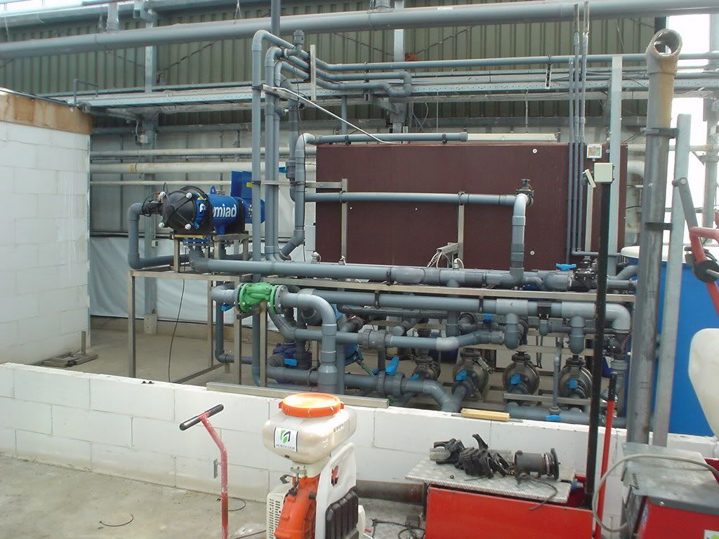

This is the filter unit. It flters the incoming water from the basin.

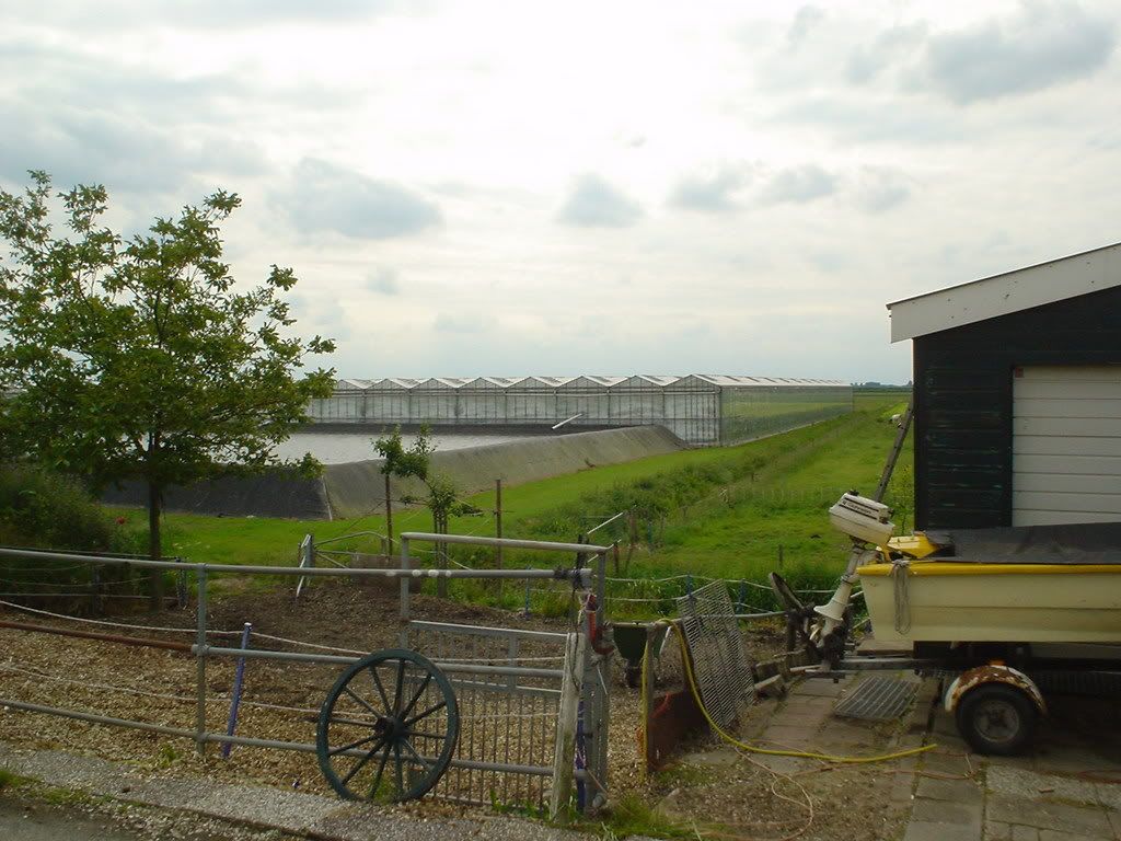

This is the greenhouse! You see the basin up front.

Turin,are you guys using the israeli made Amiad equipment in pumps and filters?
We used their gear in our irrigation of vineyards and cotton.

%^&*# h-e-l-l Turin, I'm pleased I don't run my operation in your country. That is a big big heater, and I bet it takes some $'s to run.
Your climatic situation is probably the opposite to mine.
Very impressive operation.
Picture #1.
Are those red things your proportional dosing units?
Are they electric?
I use Dosatrons (blue) and they are hydrolic....never had to adjust them in 7yrs.
Are the 200L tanks behind the controller your 2 part concentrated fertilizer?
I have a pressure pump, activated by opening a solanoid, controlled by computer. As pump pulls water thru, the Dosatrons are activated.
Picture #2 & 3
Good looking crop, and nice clean shed too.
I understand now how the rails work.
I am familar with the rockwool blocks. One of my suppliers sells them, so see them in his catologue. A nice effecient way of growing.
Picture #5
I have a lot of questions to ask you of filtration, but will leave that till later.
Please to see you have the motorised back pack sprayer on wheels. Have not used one in yrs....very heavy, and noisy. I am using the standard 15L Solo backpack for the little we do.
I used a electric big zapper for the moths, but kept blocking up with dead ones. Now use the blue-light bug attractor with the fan and dish full of water underneath. Easy to clean, and very effective. Still have caterpillars tho (not so many) so spray with systemic incecticide (Rogor) early, so keeps them down and complys with 'with-holding' periods....stinks a lot though. I should really go back to endosulphen as found that very efficient.
Last Picture:
Now this is something we will HAVE to discuss at a later date. Water/filtration is something I have been struggling with for the past yr or more.
Your operation isn't using slow sand filtration is it??????

Hi Phil Nice you noticed the filter it was installed the day i took the picture.
The day before we used 2 sand filters.
The heater Inpressive?
We have 2 of these bastards in every greenhouse.
the motorised back pack sprayer on wheels we only use that thing to spray bacteria to kill the catterpillars.
For the most plaige incekts we use biological solutions.
For spraying liquid insectisides we use a 380V electric pump and an device ill make a picture of.
