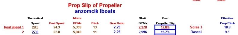

I show your maximum RPM should be 6,000 RPM and that you have a 2.25:1 gear ratio, please verify this. If this is correct I show you have 17% prop slip with the Solas and 16% prop slip with the Rascal.

I see where my mistake was, i messed up my gear ratio. I mixed up the ratio of my 9.9 which is 2:1, and my 25hp is 2.25. Now everything makes sence Good catch hwsiii. I will post my results when i get my 4 blade. Thanks
