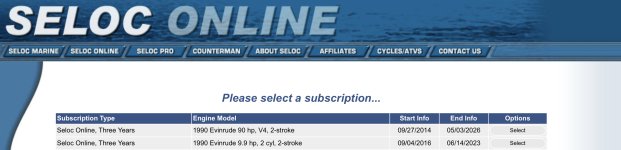

Selco is a general repair manual....get yourself a real factory manual
