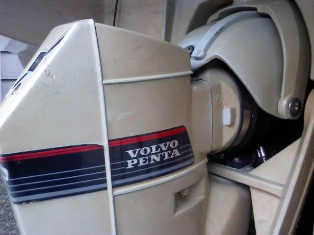

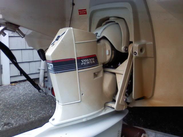

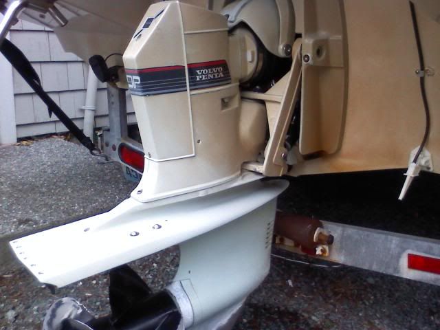

i've got what sounds like a bearing growling. i have the oem manual for the outdrive, but i'm trying to figure out which outdrive i have. i feel pretty dumb, because i feel like it's staring me in the face.
I have the serial number, but haven't found any help there. (3102157647) It's a '94 5.7gi. from 'the pictures' in the manual, it looks like a 290, or a dp-(some letter)
the bearing i suspect is the gimble, and i've 'heard' of a model of dp that you can't replace the gimble w/o pulling the engine? i've been reading thread after thread and i see talk of a model that doesn't have a gimble?
probably of no help, but it started a growling noise that you could only hear while off-step. (900rpm) it would go away if you turned the drive to either side(left or right,) but going straight (up to about 15 degrees either direction) it growled. raising or lowering the drive some didn't seem to make any difference.
the same is still true while going slow, but it now is audible on step. when on step, if i trim up (to a good planing trim) and then trim down a very small amount, it goes away (at least it drops off sharply enough that it's not audible while on-step anymore.)
^^ all of that is in case it sounds familiar and i'm looking in the wrong direction. the primary goal here is to identify the drive! lol

It's a DP-C1.
Sounds like you have water in the bellows and the ujoints are bad.
You need to pull the upper gear box, and check the ujoints, and the bearing in the flywheel cover.
Have a look at this post. http://forums.iboats.com/showthread.php?t=309095

You don't have a gimbal bearing like OMC, Mercruiser, or the newer Volvo SX/DP-S drivcs.
You have a bearing in the flywheel cover that requires the engine being removed to replace it. Which is why it's so VERY IMPORTANT to keep good bellows on that style Volvo drives. They are easy to replace and should be replaced every couple of years to be safe. They aren't nearly as thick as other manufacurers bellow are.
