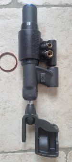

I have noticed a leak from the large cylinder (left seal under the 'P' in PENTA) on my 2017 power steering actuator. It is VP part# 21910902 Steering Cylinder SKU: VOL-21910902. Online research indicates the part is non-serviceable. There are after-market seal kits and rebuild services, but they only address leaks in the smaller upper rod. New replacement cost is $850-1100. It will be a very tight install/removal with the boat design.
Fluid level just touched the bottom of the fill stick. I could see where the fluid dripped down into the bottom of the hull and feel a slick of fluid along the bottom of the large cylinder on the starboard side (left side of image below). This is red fluid which I believe is Dextron III ATF and not Volvo Penta power steering fluid. I'm not sure if it came like this from the factory or if this was replaced during service at the marina.
Because our garage is a tight fit, I often swing the motor to one side. This sometimes happens with the engine off by pushing the motor and/or cranking the wheel. Could this cause enough back pressure to be the reason for the leak? How much of a leak is tolerable on something like this? The boat only has 120 hours and the part still looks mint. We do a fair amount of side to side over steer to correct the horrendous bow wander on this hull in order to maintain a heading at low speed (Stingray 198ls).
