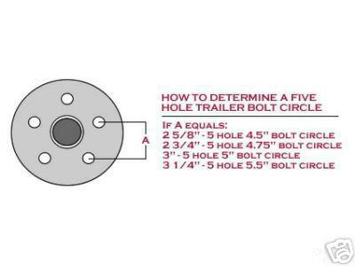

Well, I found out some information looking on e-bay.<br />
<br /><br />It seems that I have a "4.5" bolt circle" because the distance between my lugs is 2 5/8".<br /><br />Interesting that so many of the wheels advertised don't mention this spec.<br /><br />You do see tires/wheels for sale on e-bay because they didn't fit the trailer the guy was buying them for though...buyer beware...<br /><br />I'm posting this in an effort to perhaps help others here.

Trailer hubs,........... Come in 2 standard Sizes,.........<br /><br />4 bolts on 4" Circle,......<br />And,.....<br />5 bolts on 4 1/2" circle,.......<br /><br />Of course there's 6 bolt,+ 8 bolt for the Heavy axles......

Hmmm....after a day at work it's a pleasure to come home and see all these great replies! Thanks to all!<br /><br />I did stop by a tire place today and sure enough...he took one look at my wheel (the remaining straight one...) he put his gadget on it and said:<br /><br />"Five on Four and a half"...<br /><br />Sure nice to talk to someone who knows his stuff. He also mentioned Ford Ranger and also Toyota pick-ups as two vehicles that match mine...<br /><br />Now the next question...what is Back-Spacing and how do I measure to know if it's a problem?<br /><br />Thanks a lot folks...Chuck<br /><br />PS....no call back from "Wally" yet....maybe on Monday
