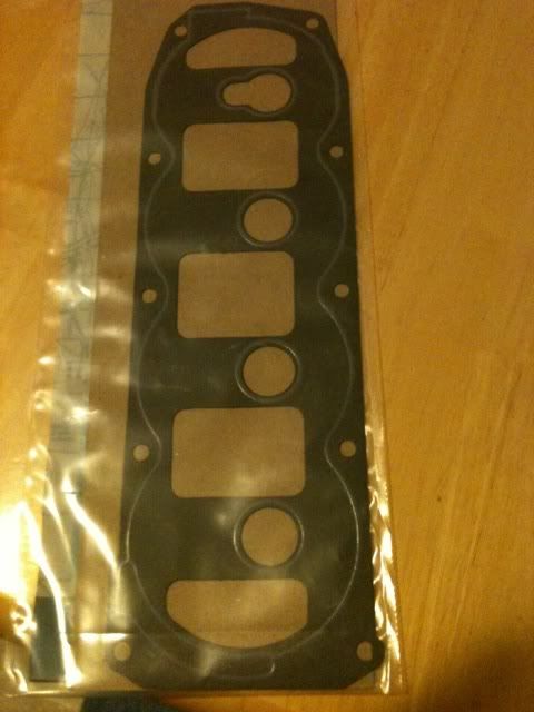

Have a 1968 mercury 500 - 50 horsepower. Ordered the "Entire Gasket Set" and they sent me gasket 27-43777 2 for the waterjacket plate (the plate that sits around the spark plugs)
I went to install the new gasket today and noticed there is a cutout for a temperature sensor - my motor doesn't have a temperature sensor and this gasket won't seal properly. Does anyone know the correct part number to get the gasket without the cutout for the sensor - have been looking, but most appear to have the sensor cutout...

Got it
Part Number
27-85487

OEM is 27-85487 or Sierra 18-2507
