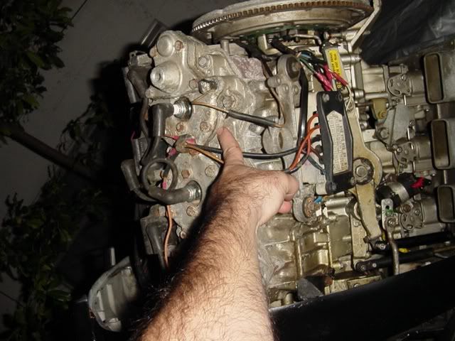

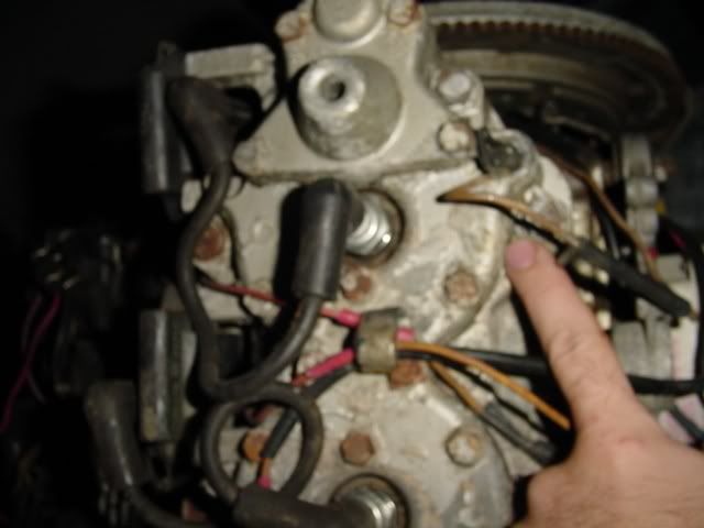

Re: water leaking from motor ??
heres a couple of pics of where the leak was coming from. It was a fairly constant dripping leak while the motor was running. Any ideas or suggestions would be appreciated. It's not normal for water to be up in this part of the engine, is it? Any ideas of the cause/problem? I'd hate to take it to the mechanic and pay $100.00 just to have them diagnose the problem. Thanks.
i've been told that it might be a simple gasket that needs replaced on top plate that the spark plugs are in (cylinder head plate?). That would make sense, as water is leaking between the plate and the engine......that isn't my main concern though.
Looks like its going to be a head gasket - easily replaced. But, I am no pro, but I have just rebuilt my 115hp V4. Have you removed the spark plug for inspection to see if you got water into the cylinder?
