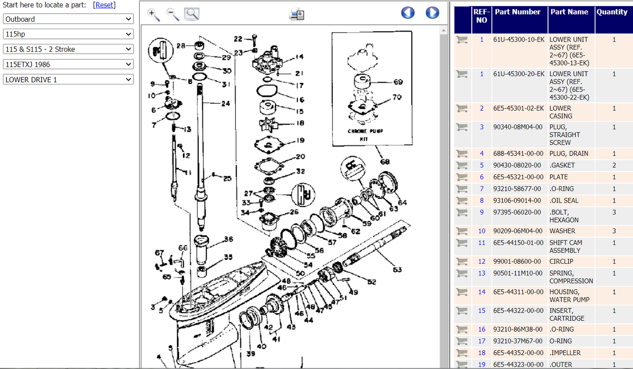

Hey all got a question. I have a 1986 yamaha 115hp outboard and it needs a water pump. Does anyone know what kind and what part number because I'm having trouble finding this

That impeller was very common for many models and years-----Your local boat shop likely has it in stock.

Probably 6E5-44352-00 but double check. The v4 and V6 around that era had the same impeller.
