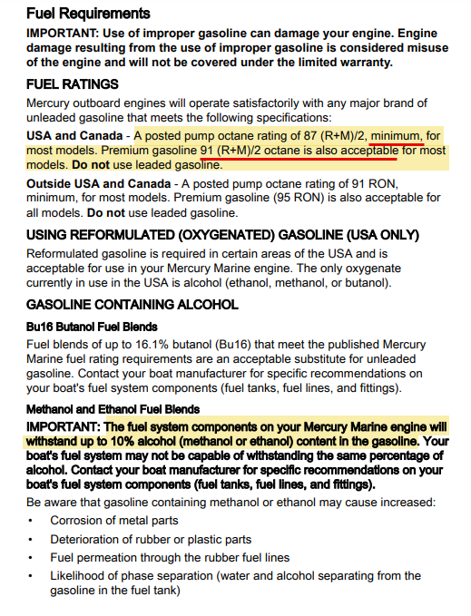

I don't believe that Mercury says no ethanol.
You can't go wrong by following the manual.

Interesting I could have sworn that the manual said ethanol-free when I read it before. Checking the Mercury site (not manual) it says E10 (so 87 here) is fine.

No mention by Mercury Marine as to performance degradation when using gasoline with an octane rating above 87. Which is the minimum. As in, higher is OK. Less is not.
