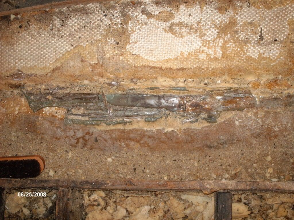

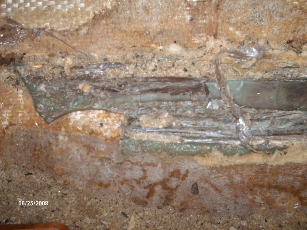

what is this on my hull floor?
77mutiny
Apr 21, 2008
35
http://i300.photobucket.com/albums/nn30/scfg95/HPIM1559.jpg
http://i300.photobucket.com/albums/nn30/scfg95/HPIM1560.jpg
Sorry the pics are kinds big, didn't have time to resize them.
This is some kind of hard plastic compound applied to a section of my hull floor, i found it after chipping out the foam, some of it broke off while i was removing the foam but the rest is stuck on pretty well. I'm trying to figure out if it is a patch of some sort....or what? I don't see any obvious signs of repair on the underside of the boat, unless the repair was made before the gelcoat and paint were applied. i have no reason to believe the floor has been replaced since the original manufacture date, but it is a 77....
thanks in advance for the help

possibly a poorly catylised patch of resin.....someone s idea of a glass job...
it doesnt look like the resin even saturated the roving......
just get out the grinder and start rippin!
yep agreed !!!!!! bad patch job !!!!! make sure you got a good mask !! john

may not even be a patch, just sloppy workmanship.

thanks for the response guys, i'll work on it after i get the rest of the foam removed, didn't know if i should leave it, or try to remove it. but i'll grind it off.
i'm thinking somone must have redone the floor at some point before me, i've found so much weird stuff in the floor during the removal, at one point there was a plastic liner around the foam, at another the was a pvc pipe in place of a stringer, unless the bayliner factory chucked in whatever they could find to build their boats back then.....i wouldn't be surprised.
once i get it all hulled out, and start rebuilding should i take the boat off the trailer before fiberglassing? will it bow out once i take it off the trailer if i didn't do the work off the trailer.
i know i'm gonna have to put the cap back on before i glass the floor, but i wasn't sure about the stringers?

It may have been some sort of liner or bag used to isolate the foam in the hull, sort of like filling a trash bag with foam while inside the cavity?
I've cut apart a few that were done that way. What make boat?
I had one that had what appeared to be foil backed Tyvek lining the areas between the stringers and all around the trapped in fuel tank. I wasn't sure if it was to make the foam less a part of the boat or not but if so, it didn't work, the foam had expanded all around it and into every little crevice.
It could have also been a barrier to stop the foam from expanding too high, whether to prevent it from adhering to the upper layer or the sides of the boat beyond the floor?
They also could have been trying to make a water proof barrier to keep bilge and deck water from soaking the foam? Encasing the foam would make it more water resistant in a draining bilge or protect it from deck drain off.
