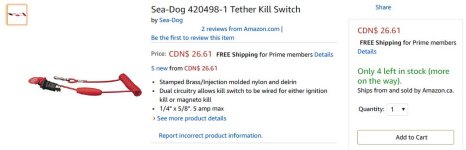

If you never had a kill switch at this location, it may be a provision for a futur install, blocked by a plug, that got lost at some point. My Volvo shifter has the kill switch but just below. On the picture, I removed the switch to replace it with a new one.
