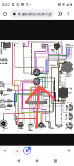

MANY thanks to Crosbyman for digging up the schematic! Now, am I reading this right. It looks like if I close the purple with white and black with yellow that come off the switch, I should at very least see spark at the plugs providing the speed controller is functioning in its neutral position. Also, it looks like the S marked switch terminal white wire is the power to starter.
As far as putting battery power to the key switch, What I want to do is just do what the key would do in the run position by jumping the purple with white power lead to the M terminal, then momentarily power the S terminal of the starter. That should turn the engine over with spark. As long as the shift selector is in neutral, there is no need to power the A terminal on the switch.
I have zero experience fiddling around with engine controls like this so please jump in and correct me if I have gone off track with this assessment. I have no intension of getting involved with cleaning the carburation on this engine and checking the various components for proper function. I just want to be honest about how far the engine is in its possible working state. On top of the fact, this wont fit in my garage with the engine in place. Its got to go. The boat looks like it's floor was redone at some distant past but needs to be pulled up and a full hul inspection and update done. While I have some of your guys attention, I would like anyone's opinion on what is a good reliable relatively new engine and control to replace this with that is the gold standard in parts replacement and reliability. The Boat is OAL of 16' and weighs in at about 500 lbs with its tri hul design. No intension of pulling water ski's. Just a nice quiet fishing and lounging around engine of about 35 or 40 hp. The past owner bolted what looks like an aluminum trolling motor base plate to the front of the boat.

No, it has a rubber type conduit with wires individually going to separate terminals on the engine and threw out to the battery and controller. I wish you were right on that! The Factory Fabuglas spec sheet says approximate boat weight is 500 lbs for my 146. The Trident 154 is 650, trident 170 is 900 and Trident 170 1/0 is 1700 lbs respectively. The 146 is perfect for what I want it for. Huge plus, is I can have it in the water inside 30 minutes from my house. Cant beat that with a stick!
Wiring scem shows this plug.

OK I think I understand what your saying. The key switch has the black with yellow grounded in its off position, in "run" it opens that circuit. So the jumpers I pictured are actually meant for a kill switch that was once in that hole above where this jumper cut in the wires are. Many Thanks, I'm maybe more than a little slow but eventually catch on.
Saltchuckmatt, You are right. I thought the plug was out side the engine but upon further inspection, its there inside the engine compartment. So I did as you said just now. Unplugged it and jumped the solenoid and bingo, I have good spark at the plug. Sorry for being dumber than a box of rocks with all this..... You guys are the best.

Lol, no problem.
At this point hook up some fuel and water and see what is does?
Without the plug in you will have to figure a way to kill it.
