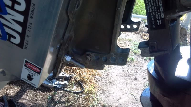

Dask, as usual great informative reply. Yes it has been a great motor, unbreakable (knock on wood). Yes, the motor does have 2 inner shocks but seem very weak and do not provide much downforce. With the original leaking tnt, i ran a long bolt thru the 1st hole (closest to motor) to keep the engine up in a decent trim level. But i dont understand the zip tie concept to prevent the motor from kicking up. What is the top tilt pin???
dazk14
Ensign
Jul 22, 2008
966
Re: whats holds my 135 to the bracket
Ok, same concept using the outermost holes. Drop the motor to it's lowest position. Now capture the motor/swivel bracket in the low position by running a heavy duty zip tie across between the starboard and port "5" holes.
You used a homemade tilt pin to prevent/limit forward movement, now you'll simply do the reverse and prevent outward movement - without being as strong...
Because, without knowing whether the CMC unit is designed to release when hitting an underwater object, I wouldn't suggest bolting it down.
Easy to test, run it firmly in reverse and see if you need more than one tie - they're cheap.
Just to confuse matters more and as a 2nd option..."start with the 1st"
The swivel bracket should have holes that would have been drilled for non trim models that could also be used. I think you would need 2 separate ties... Look under the swivel bracket to see these holes. They are inboard of the pads that contact the "Thrust Rod" or tilt pin as it's more commonly referred to...aka your homemade rod you installed.
