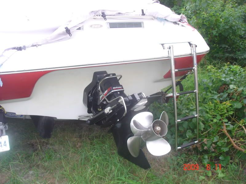

Here is the back of the boat with the ladder down. She really has a hard time getting in. Years ago she had arthritis in her knees and refuses to ever really get on her knees. When I get on I just tap one knee down and then I get right up on the opposite foot with no problem. Any suggestion on what I could put on the back that would look good and make it easier for her to board the boat?

perhaps a better hand hold around or near the rear cleat, and at least another step between the two you have now
i say this, as I to had trouble getting on our old boats swim platform. our current one uses a 3 step ladder so the distance between is much more manageable for some one with sore joints

Trying to visualize looking at the back of the boat where she is having trouble. She gets her foot on the ladder step just fine and gets ahold of the handle above the vent. It's getting from there onto the swim platform and up onto the back that is the problem. If there was another step she would be fine. It is a pretty long step from the ladder to the swim platform which I really can't do either w/o using me knee. The younger thinner people just step right in.

thats what it looks like to me jim. seems like you have a handle on her problem.
to big of a step from the bottom step to the platform. in the pic it looks like the top step dosnt do much. i might be missing the angle and use of the top step though

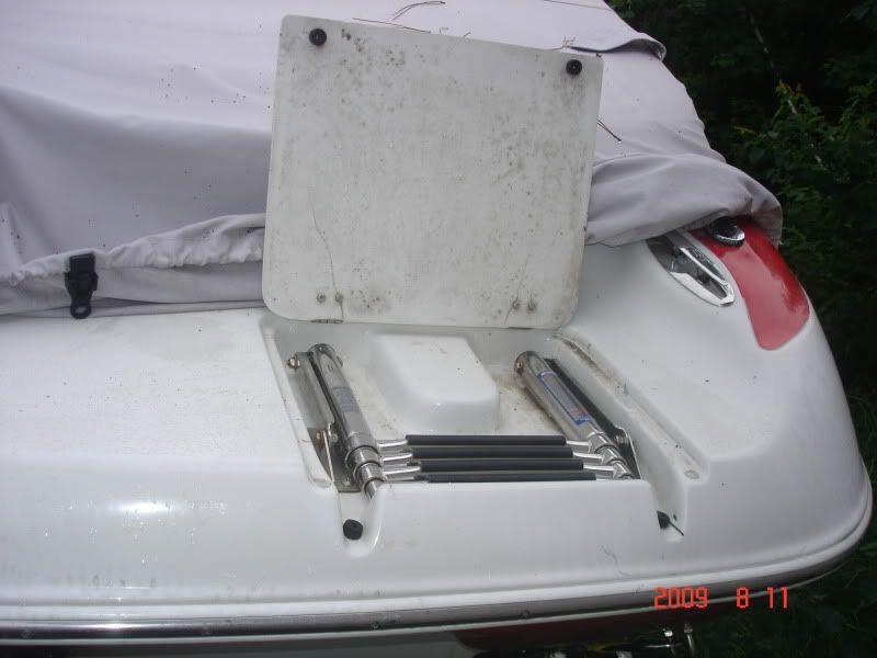

Your best bet is probably an "over-platform telescoping ladder" like these:
http://www.iboats.com/Windline_Over...753237294--**********.628006021--view_id.4470
It'll mount on top of the swim platform, and give you three or four steps, with the final one much closer to the swim platform then what you have now.
Yours would have to fold flat onto the swim platform, you don't have enough real estate back there for it to mount into a hatch like on my 225. It would fold the same, you would just be able to see it folded onto the swim platform.
Folded ladder:
4-Step ladder extended:

jim here is a pic of what it took for me to be comfortable getting in and out of the water
not close to what you have but might give you some ideas.
more steps pulse the hand hold where i can pull my self up from realy help me. for reference the swim platform is 3 to 4 inches above the water in still water.
nice pic and idea 45. wouldnt have posted my pic in if i had seen yours first.
looks like just what she needs

Jim, I see another problem you may have overlooked. The ladder is attached in underneath the rubrail, so when you are climbing back onto the boat, you are vertical, or even leaning back slightly, virtually forcing you to put you knee forward. My wife has similiar issues, so I can visualize where she would have difficulty. Having more steps may not do it. With your boat style, I would have to install a folding ladder with a curved top that would be outside the rubrail and attach approximately where your left handle (or line tiepoint) is and the other side on the platform. I guess that would have to be custom.

Since I started this conversation, I just went out, put the ladder down and tried stepping up onto the swim platform from the bottom step. I could barely lift my leg that far on dry ground with nothing moving. The ladder is made by Windline (still has the label on it). I wrote down dimension and will see if I can find a ladder that will provide a step higher. There is no problem with leaning backwards.
I really think having the bottom step about six inches lower and another step halfway between the current step and the top of the ladder would do the trick. I do NOT want one laying on top of my swim platform. I have to figure out something that will fold up under like this one does.
