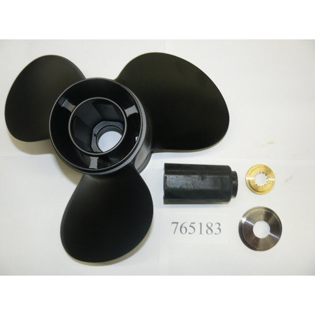

The V-4 series will work but use one from the aluminum D series
