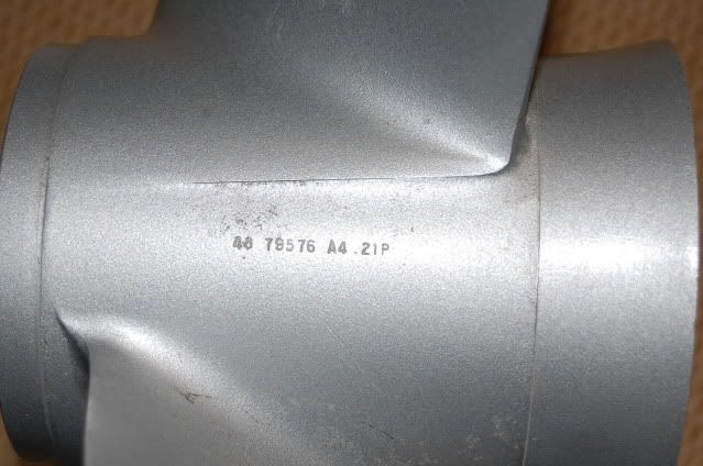

Have a 21ft boat, 165HP mercruiser, that runs great on it's original prop; 17 Pitch 16 diameter. (48 66450 AS4 17P) but getting worn out a bit.
Have also a still new 13 3/4 diameter 21 pitch propellor. (48 79576 A4 21P)
Would it run similar with the 13 3/4 21P as with the original 16" 17 pitch or better to get another 16x17P?
Thank You all in advance for your wisdom.

Putting a 21" prop in place of a 17" will drop your max revs by around 800rpm, and cause your engine to be SERIOUSLY overloaded... If you are getting close to 4300rpm with the 17" then get another one of those. If your only at about 3900-4000, then drop down to a 15"....

generally speaking.
an inch of prop pitch is worth aprox. 200 rpm. like achris is describing.
i had a 21p on my 165hp when i got it. a 19' boat. my wot was 3900. the low end of the spec. i went to a 19p and gained 400 rpm. now my wot is 4300. right at the top of the spec. 3900-4300. generally speaking. you want your wot rpm right at the top of the spec.
your boat is 2' longer than mine and probably heavier. i'd think stick with the 17p too. it just depends on what your wot rpm is. speaking of which, what is your wot rpm? that will give folks something to chew on so they can offer their ideas..

You guys are missing he says the 17" pitch is a 16" diameter 2 1/4" inches bigger.I think he needs to measure the 17
to confirm the diameter. I'd have to wonder if the 16 barrel is bigger than the 13 3/4?If you measure from center to the tip of a blade and double it will give the diameter.A 16 X 17 would surely turn slower than a 13 X 17 A 21 isn't going to work and the 16 diameter would normally be found on a heavy application perhaps like the boat in question.

Measured the prop and it is a 16" one on the boat.
the spare one is 13 3/4".
Does the smaller diameter compensate for the steeper pitch?

Wouldn't hurt to give us the details of your present performance.
It will give us an idea of how well your setup is working.
Diameter will make up for some but
I don't think the it can make up for a 4" pitch change Won't hurt to try it
And it will give you some different numbers to work with. I believe the 165 is rated at 4600.

engine runs WOT @4200 rpm and 30 knots.
accelerates seriously fast
Boat could be 2 ton all up with 200ltr fuel and 50ltr of water.
I realy never run WOT almost all times between 2500 @ 3000rpm doing 17-20miles/h which the boat clearly like to cruise on.
I guess the best way is to bolt the prop on and go for a testride.
If I get another new 16"/17P prop then it will be a Stailess Steel number as these pollised up are also acting like a teaser while trolling I think.
But, they are pricey here in Australia.
Boat's max HP rating is 200HP from factory back in 1978 I believe

165 was recommended max rev 3900-4300rpm. I had a 165 in my boat for the first 8 years of owning it, and got 4250rpm at 30knots with a 15" prop. His boat and my boat are very similar in hull shape and mass. And I have seem 165s put in a lot bigger boats than ours.

I can get a 16"- 16 Pitch no problem Michegan Match 031051 in ali.
So it is :mad: 16" and not 17P.
This why I posted the question as no perfectly matching prop is around it seems.

17P means 17" pitch... Most of the large diameter props were even pitch, I've never seen one with an odd pitch....

Assuming a 1.7 gear ratio 4200 @ 34.6 mph is about 13% slip respectable for a heavy boat.
A boat with quick hole shot that stays on plane at @ 2500/17 mph with wot right on 4200 and apparently trolls well seems like it would be hard to improve on that.Maybe I'm too easy to please.
http://youtu.be/ba_kvI88OHw short video of it cruising
Gear ratio : 1. 65:1.
Yes It feels good and like to keep it the same, Do not want to "Improve" just a new prop as this one seems from 1978 and has seen better days.
I am going to go to a Mercury dealer here and have a chat to see what is available, as close as this, to replace.
