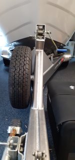

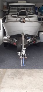

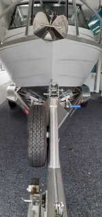

Hi all,
We have had our new boat for about 12mths. It is great but we have this annoying problem of when we are retrieving the boat it nearly always loads up off centre. After checking and rechecking and trying many different things to get the boat to load level we have noticed that the winch Post seems to be on a lean of centre of about 10mm and the rope is always hard over on to the left side of the roller.
Question is: if the Winch post is off centre we believe the boat will nearly always load up unevenly when winding the boat onto the trailer. Hence we always end up jacking up the boat to centre it.
Heeelpp :)
Some pics attached . I would have thought if we are retrieving the boat on a crooked post gravity will pull the boat on a crooked position

I have attached some pics of the post . Once we allign the boat it sits perfectly on the rollers everywhere.:-(

Thank s JimS123. Question for you. Would you buy a boat and trailer that has a lean on the winch post?
JimS123
Jul 27, 2007
8,287
I might buy one, but I wouldn't use it.
If it was a used boat I would replace the winch post with a heavy duty model and set it up myself to be perfectly straight. In fact I have done that twice over my years of boating.
If it was a new boat, I would require the dealer to repair it.
Truth is, though, that if it's only 10 mm off center, and that the rollers were aligned to guide the boat to the center, I would imagine that the boat would still center OK, with the only issue being that the rope or cable would be all wound on one side of the spool.
It's hard to tell from the pictures, but by my eye the winch post IS centered Ok. It looks to me that the winch mounting plate is crooked. If that's the case, simply move the winch forward or back and re-drill the holes to straighten it out. In other words, make the winch straight in line with the boat, not the top of the post.
But of course, that would only be a last resort if the dealer won't help. But another of course is that if it were me I'd do it myself for fear that the dealer would screw it up worse.

Looks to me like your port side front rollers are higher.
Starboard side are lower.
If so, that would cause the boat to load to starboard side of trailer.

The trailer is custom made for the boats and yes everything is square and true except when I get to the winchpost. The trailer is aluminium and the draw bar is two C sections welded together and then the post and its supports are all welded to this . What i think has happened is when I check the level of the welded C Sections one C section is slightly lower than the other that being the starboard side section when lookng at the pics. So when they have welded the post set up to it it has welded on crooked and they havent checked. I have been thinking that if winching with a post that is on a lean and its centre is not over the centre rollers, even if I bring the trailer out of the water a bit further the winch will pull the front of the bost to where the load is coming from effectively the drum in the winch and hence it loads untrue. If I pull the winch rope all of the way out and attach it the rear centre roller the winch rope goes from the centre of the rear roller and you can see the angle it takes back to the winch. After the second centre roller you can see the angle difference to the winch is quite a bit. If I wind it to the left side of the winch drum it passes over the middle of the centre rollers and the boat centres it self. As everyone is alluding to the post shouldnt have a lean regardless and dont bury the trailer to deep and this will solve the unlevel loading. Will try it all and see the success rate.

It looks like a custom built trailer, and it also looks to have been extremely well built. It also looks like a pretty big boat. That said, winching it on must be a chore, thus backing in too far is the logical approach.
The second observation is that all of the gear is welded on, with no way to adjust rollers. Thus, you are going to have to make due.
I noticed that too from the pictures. Use a level on the trailer frame and on the gunnels. You may need a straight edge across the gunnels to do that. If the starboard side was lifted a little the bow eye would align.
