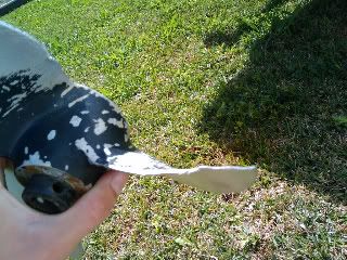

i'm going to go take off my prop right now and look for some numbers. i'll come back with pics.

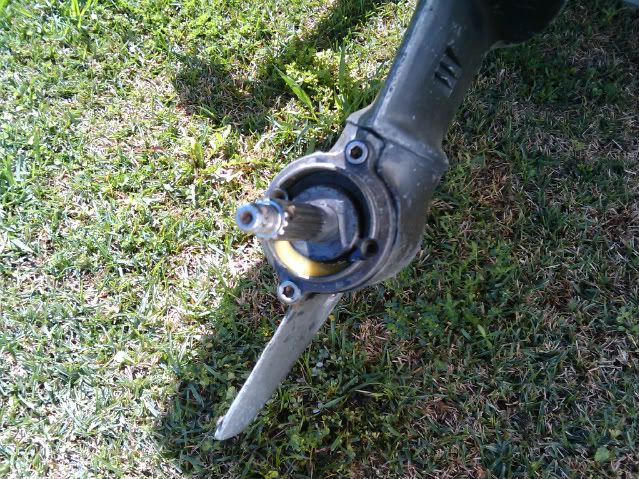

here are pictures of my prop. Its a "michigan" brand. The only numbers I could find on it said "PR 130" I'm posting in the prop forum as well :redface: so maybe they can interpret that.
oil coming out around the propeller shaft? :confused: i just rebuild the damn lower end.
