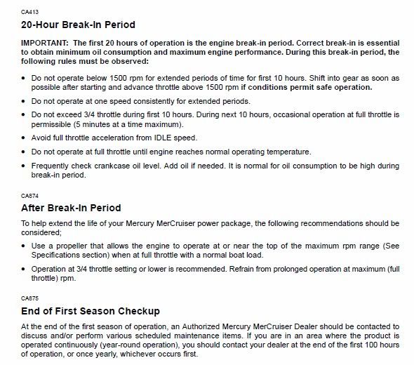

Mercruiser recommends in their owner's manual that you operate at 3/4 throttle or lower, with no prolonged operation at full throttle. Up to you to decide what "prolonged" means - just remember, if you want to play, you'll have to pay! :D
