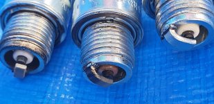

Howdy folks, after an evening messing with the engine and mosquitos here are the results:
Compression test conducted below operating temp, about 130 PSI for each cylinder. Minor variations. Maybe the number would have bwen higher should I have kept the starter on for a bit longer.
Spark plugs also replaced BR8HS, the store didn't have BR8HS-10. Only the connector tip at the boot side differ.
Result, first run with cowl off I got pretty food speed for a few minutes then it bogged down.
Lower unit did feel a bit warm actually after the run. So I wonder now if perhaps t-stat or impeller is properly doing its job. My hunch is safe mode due to "overheat" but that is my guess.
Anyhow, the engine doesn't run perfect either at low throttle after it has had its top speed run.
Photo is of the just newly replaced plugs;
Igniting end,
Right was living in bottom cylinder
Middle in middle cylinder
Left in top cylinder
Boot end,
Top living in bottom cylinder
Bottom in top cylinder
Any further suggestions or conclusions are welcome.

39,225
Sparkplugs should all look the same.----Too much fuel on #1 and #.----No spark on 1 and 3.----Crankcase compression issues on 1 and 3.
1up
Jun 6, 2012
36
Thanks for feedback. One look oily, one look like it never got spark, plug for bottom cylinder. I feel I need to verify spark, testing leads first. I was alone at the dock today. With a helper I can ground the spark plugs and check for spark.
Perhaps as mentioned there are bigger issues. Still engine sounds and goes well those minutes it pulls before bogging. I am not giving up on her yet.

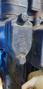

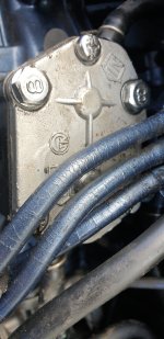

So I got one hour at the boat dock today. I opened the fuel pump to check the condition of the membrane. I could not see any tears or issues with it. Granted, it seemed paper thin though, but appeared intact. Of course a spring from the bottom fell out and a shim. I captured the spring, the shim fell down into the cowl. To be magneted / searched for later.
The thermostat housing appear to have not been touched since 1987 when the motor was put together judging by the paint on the housing mating surface. The aluminium? bolts was stuck a bit. One snapped.
So that'ts how it sits right now. I got a spark plug checker, inline variant with testing light. That's next on the agenda, for another day.
Is it easy to see if there is an issue with the membrane of the fuel pump? Just so I didn't miss anything.

99yam40
Sep 7, 2008
9,211
usually just remove the pump from the block and pump the bulb to see if any fuel come out the pulse port not along the edges.
with the bolts removed you might see leaks between the parts
1up
Jun 6, 2012
36
Perhaps I overdid the check then. What does 'pulse port'refer to? I can see an 'In' and an 'Out' fuel connector on the pump housing where the fuel line comes from the fuel filter, the out side seem to feed the three carbs.
99yam40
Sep 7, 2008
9,211
it is the hole on the backside of the pump into #3 crankcase that furnishes the pulse to the pump diaphragm
1up
Jun 6, 2012
36
Interesting. I need to review that. Does that mean a vacuum line would go between the back of the pump and the crankcase? Not sure I saw such a hose.
