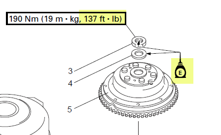

Hey I was just trying to figure what the torque spec for a 05 90TLR Flywheel nut is?

B boscoe99 Commander Joined Aug 22, 2013 Messages 2,193 Apr 5, 2022 #3 Time to man up. 137 pound feet. With the nut being oiled. No oil or lubricant of any kind on the tapers.
