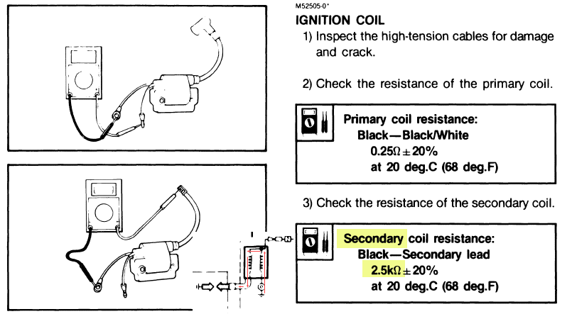

It probably won't matter but I would retest the coil using the Yamaha specified procedure. From the ground point of the coil to the output lead to the spark plug. With the plug cap removed.
boscoe99
Aug 22, 2013
2,058
If the coil passes the test using Yams procedure, but does not pass using using your procedure, the problem might, repeat might, be in the connection point of the male bullet terminal to the wire. You might get lucky and find a poor connection that can be repaired. In lieu of buying a new coil.
