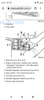

Not sure what 99 is saying because you made no reference to the relay clicking. Here is where some Yamahas hide the fuse. Port side front in a box.
