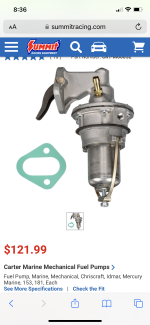

This is the one I see for a 3.0. It has the Longer arm so I assume it needs the spacer. Is this correct?

Hi Scott I appreciate the reply. I found the pump at summit racing. Just wondering if u know if the thick spacer is used or just the thin gasket with this pump. I know that Yamaha used the thick spacer with their pump but I’m not sure what length or style arm they had. Thanks again

Ayuh,..... Welcome Aboard,..... Mount it up, 'n try it,.....
If it supplies 4 to 6 psi,yer good to go,.....
If it over-pressures, add a spacer block,.....
