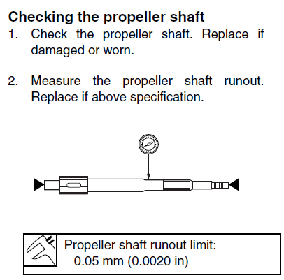

Hello,
I dissasembled lower unit of yamaha 9.9 4t 2004. I have to change oil seals. I notice some radial shift of prop shaft. I changed needle bearing but prop shaft still has radial shift. It is cca 0.2mm. Is it ok or not?

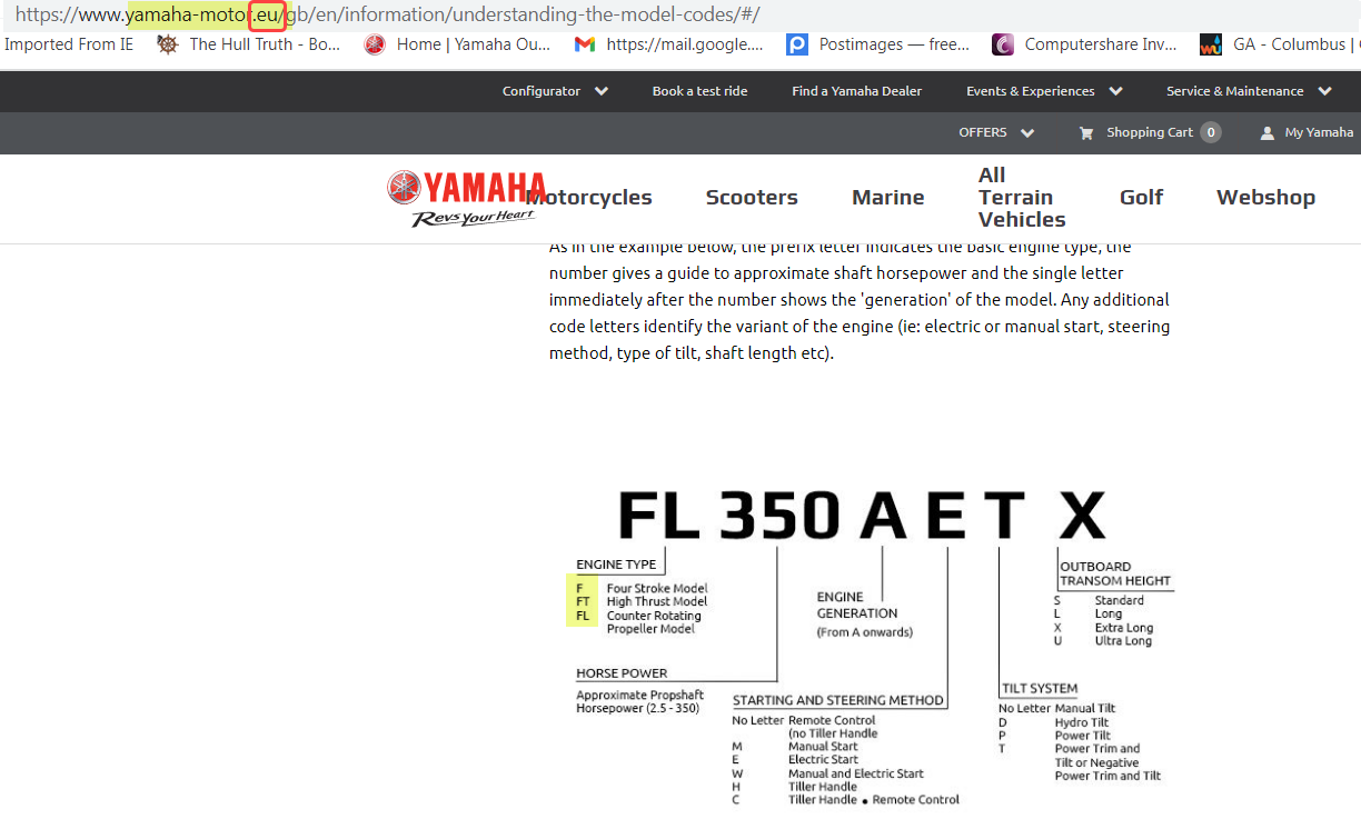

All Yamaha four stroke outboard motors are preceeded with either the letter F, the letter T or the letters FT. With other letters thrown is an needed.
39,226
Everyday talk in Europe is different when referring to number of strokes of the engine.

In the future it would be helpful if the full model identity were to be posted. In your case, F9.9CMHL. Better still, the complete engine identity. The ID on the label that begins with the number 6.
I have reviewed several Yamaha F9.9 service manuals. Can find no specifications for "radial shift" of the propeller shaft. Whatever is meant by that term.
I did find this:

Is it possible to order this part only. Not the whole axle.
There is no part number for this part, only for the whole axle.
99yam40
Sep 7, 2008
9,211
if it does not have a part number, I do not see how it could be ordered
39,226
Have your local machine shop fit a new sleeve on there.-----That might be within your budget.
