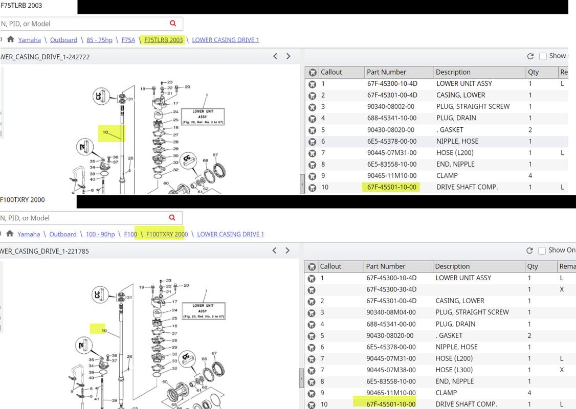

Looking at the parts breakdowns…. I’m seeing different part numbers for the 75 and 100 and the 100 has lists two different part numbers for the shaft.
Don’t know the differences but your dealing with three possible part numbers

Thanks dingbat. May I ask where to go to try and determine if there are differences between those driveshaft part numbers? I used boats.net to look at the parts breakdown, and for the 2000 model year, they do list that the 75hp Yamaha lower unit is compatible. I also measured the shaft lengths and diameters (used a micrometer for diameter) and they seem to be exactly the same. I counted the splines and each has 18.
Is it possible that the differences in those 3 part numbers are simply spline thickness?

I am seeing the exact same part number for a 2003 F75 and and 2000 F100.
I have always swapped the gear case on the larger Yamaha motors with the motor in neutral. But I don't think that is your problem.
I was comparing 2003 models. Didn’t catch the switch to 2000
