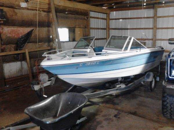

I just got back from Afghanistan. I am ready to work on something with out guns on it. Before I left I bought this for the family,a 84 Rinker V170 open bow. I got it for a song. It has been swamped at least once. The 2.5 I/O liter is ok,I would like a little more out of it. but for now I am just cleaning up the hull. The PO left it in the water all the time. I also plan to check the mechanicals again and redo the interior.
This is after I cleaned up the hull.

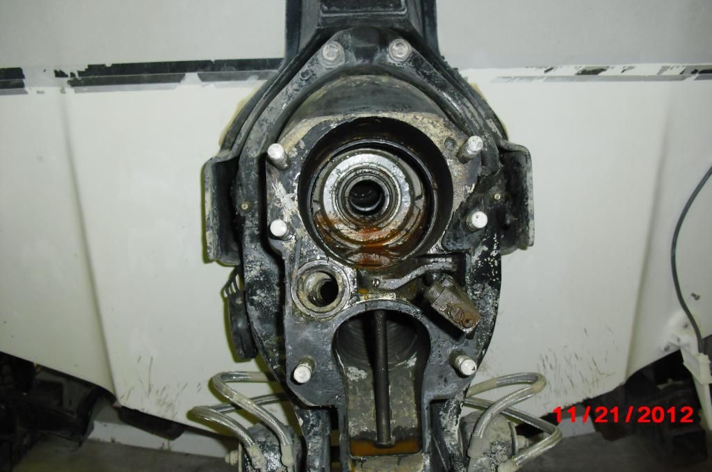

Pulled the stern drive off.
Bad news : While pulling off the stern drive I found a fair amount of water in the driveshaft bellows. I dont see a hole. Which makes me think its been real wet.
and my (new) gimble tool rounded itself so I am sorta half done pulling the gimble, So I gotta find another. oh JOY

Got the new trim senders in and inspected the old gimble bearing, The water must have been there for awhile. The bearing doesnt go around anymore.

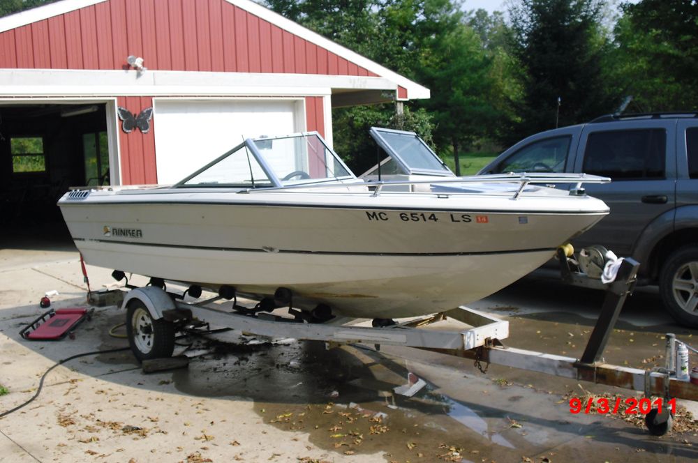

I bought another Rinker tonight to cure some of the problems I have. It has the 3 liter and cleaner hull. Now just finish up the bellow and swap some parts around and I will sell my original. Pics coming of the new boat.

Pic of the new boat, I have a fair amount of parts swapping before spring.
