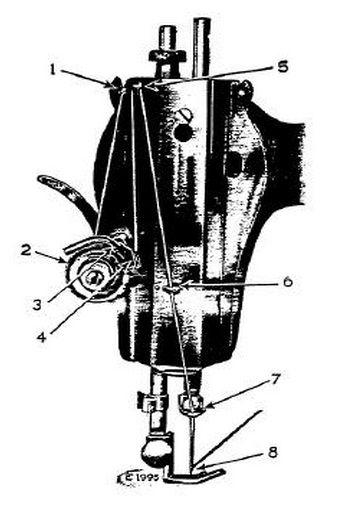

This should be a close proximity to how to thread the machine.
As I stated before, you should open her up and wash down any and all moving parts with Mineral Spirits and then blow her out. Then use Sewing Macnine Oil ONLY to oil her back up. If you do this she should run like new. You can buy belts etc online, either on ebay or from here...Sewing Machine Parts

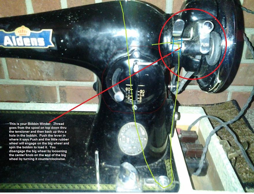

Now the lever on the side at the wheel end...is that for needle speed? Slower or faster for vinyl?

Take a better pic of that lever for me. I can't see what you're referring to.

Oh, OK, Nope that is the reverse lever. You pull it down to make the machine stitch backwards. You always want to start and end your seams with a couple of back stitches. Two stitches forward and two stitches back then go on with the stitch. That way it won't ever unravel on you. The numbers are the index for the number of stitches per inch. You want it on the lowest number possible to give you the biggest stitch possible.
This might help show you what I mean. If you need help PM me and I can make a video of how to do all of this for you on my machine. It's really simple once you SEE it done. Trust me...If this Dumb Okie can figure it out ANYBODY can!!!!:D

So you load the bobbin from a threaded spool that you buy...then load the bobbin at the neddle end...thread it to neadle and start sewing.
