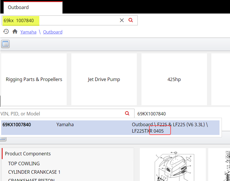

LF225TXR Ser#1007840 Letter "K" on bottom of the tag.
The year sticker is missing.
Any idea or how to figure out the year??
I tried. THANKS
boscoe99
Aug 22, 2013
2,189
69K is the prefix for an LF225. You can see this on the engine ECU.
Then add the X for the shaft length. Followed by the serial numbers.
Complete engine ID would be 69KX 1007840.

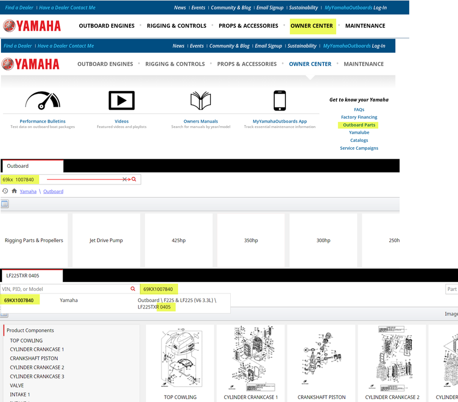

Now go to the Yamaha USA website. Open the parts catalog. Type in the engine ID in the search box. It will take you directly to parts book for that specific engine ID. It will also indicate the production year.

My cut and paste was from the main website. I see now that the mobile version is a bit different. To get to the same place.
99yam40
Sep 7, 2008
9,209
I am on a desk top Dell so not sure I would say it is a mobile version
99yam40
Sep 7, 2008
9,209
that is what I use to see with Firefox, but not what I see with Edge
