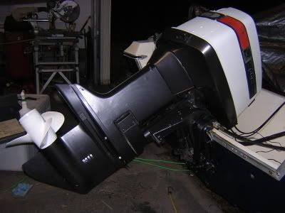

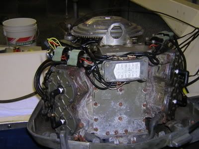

well after about 6 months and $900-$1000 ive finally completed my powerhead rebuild. this was my first go at this and am very pleased w/ the end result(startup pending).
the reason for the rebuild was a failure of the wrist pin bearing which ruined conn.rod and piston. below are a couple of pix.while at it i repainted everything but the carbs. the reason i didnt paint carbs was that everytime i decided to do something extra the motor would bite me with a bolt breaking etc.. i dont want any paint flakes dislodging plus all the moving parts besides i can live w/ it like this so thats all that matters.
before:
after:
alright so tomorrow im going to start it for the first time. please walk me thru anything special i have to do.

tschamp20 -- You need to treat that engine as if it were brand new and break it in slowly. I would not run it at WOT for very long until it has at least 10 hours on it. And if your WOT is 4800 rpm then you are about 700 rpm short of where you should be.

Did you paint the lower unit and the shaft black? Looks good!

congrats bud,what was it? yes i did paint but i believe the color is charcoal metallic or somethin like that. its made by tempo, i got it from west marine. the easiest paint application ive ever done. some grease remover 120 grit paper and thats it.great paint!2 cans.btw, that paint i showed you fell thru,i think that site,stemtostern,com isnt active.they never processed my order after 2 weeks.
