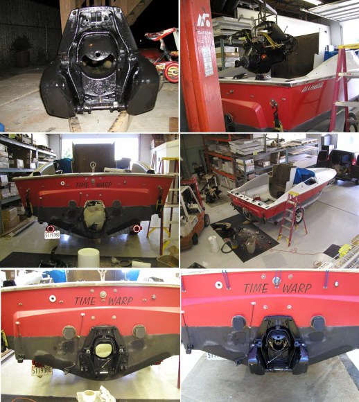

Hey guys thanks for the help that you all were able to give. <br />With yours and a few others help and after turning my bilge into a sea of transmission fluid a few times because of changes I had to make I did get the Mercruiser pump to a bunch of home made stuff to the Volvo 280 T trim shield and then to the cylinders to work together. It actually went together pretty simple. It was me that screwed it up a couple times but once I worked through the screw ups I had trim.<br /> I still to this day can not understand why someone has not come up with a after market trim system based on this design for the older Volvos. There is sure enough of them still around and there is plenty of interest with the folks who own them. Oh well after 5 years I have trim again (I had a MerCruiser before) and anyone who wants to copy mine can to. Just send a check to
