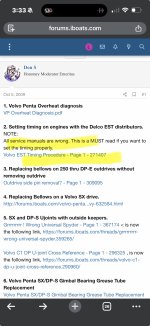

I’m trying to click on the sticky in the must read for delco EST in the Volvo penta section here: IMG_6338.jpegand when I do it takes me to some thread about an Evinrude outboard.IMG_6339.jpeg ?
I’ve tried using a different browser with the same result. Anyone have the most recent service bulletin for setting base timing on delco est using the timing shunt?

I’m trying to click on the sticky in the must read for delco EST in the Volvo penta section here: View attachment 415353and when I do it takes me to some thread about an Evinrude outboard.View attachment 415354 ?
If desired, give that link in there another try as I was able to locate the tread in question online and then repaired (reedited) the link so it works now... Or here's a direct link too,
