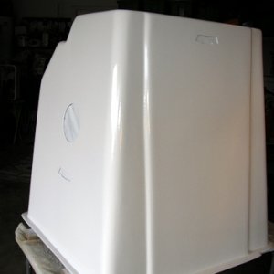

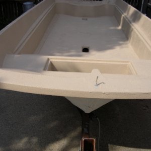

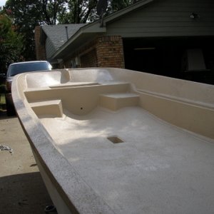

After gel coat refinish
Jet Wrench
Dec 26, 2010

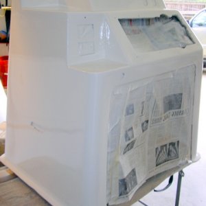

Shot the center console this morning. Applied a two part epoxy primer first and painted with Interlux Brightside. I tried to brush it first (bad idea)
Jet Wrench
Jul 4, 2010

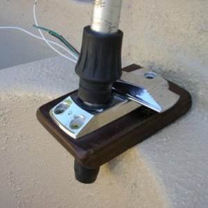

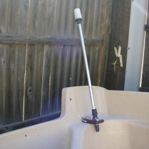

Stern light mod.
Jet Wrench
Jul 4, 2010
Stern light mod.
Jet Wrench
Jul 4, 2010

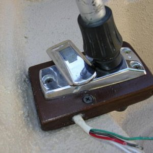

Stern Light mod. A reproduction stern light for this year Whaler is very expensive. I decided to make my own base with parts I got when retrieving the
Jet Wrench
Jul 4, 2010

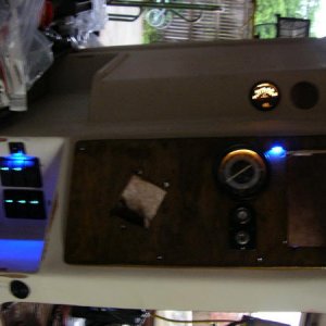

LED instrument panel lighting, lighted switches and internal gauge lighing illuminated for test.
Jet Wrench
Jul 4, 2010

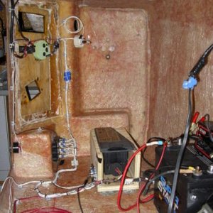

Behind main panel wiring.

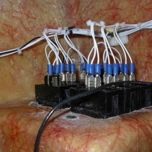

Switch wiring (all spade terminals are soldered in addition to the crimp)
Jet Wrench
Jul 4, 2010

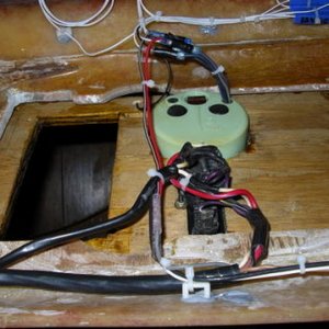

Console wiring: Started from scratch, used a sub fuse/relay panel from a Buick Sylark that contains my up/down relays for a CMC tilt/trim plate and fu

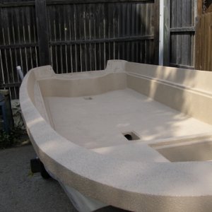

I decided not to re-gelcoat the interior... too much crazing. I decided to use a sand color Durabak anti skid material. Great waterproofing and looks

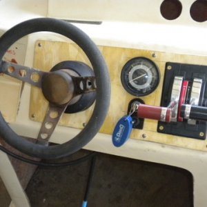

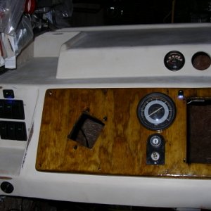

I decided to keep the wood for the instruments until after sea trials, then I will swap to aluminum. Oak stain and three coats of clear. I want to get

Designing the instrument panel layout

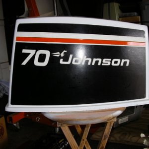

Cowling after paint

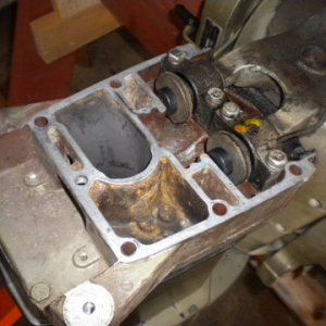

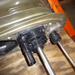

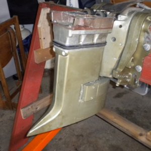

Patiently awaiting a new gasket for powerhead / lower unit assembly!
Jet Wrench
Jul 4, 2010

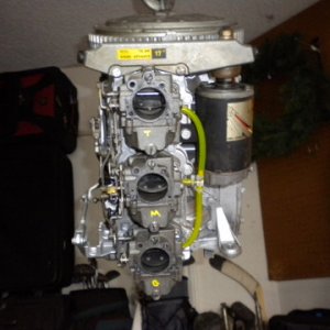

Freshly rebuilt carbs.

This is the second powerhead after dressing out the harness, carb install, etc. I toasted the first powerhead (1975 70HP Johnson), my bad! I over reve
