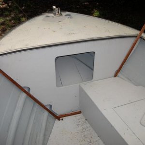

To get the fore deck to drop at a right angle so the trim work will mate up, I figure add at least three inches. The floor block could probably be fu

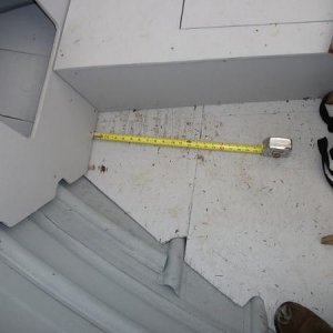

Since all these SCs should be the same, this is the length from last deck seam to anchor wall.

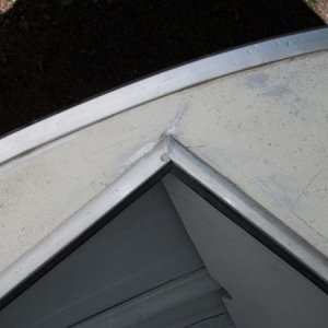

Starboard side trim fit. Notice holes in the salvaged metal. Someone had mounted pole holders and canopy hardware on them.
West Coast Willy
May 26, 2010

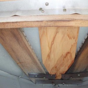

X-ray vision again here. This is how it's attached to deck and other is for interior shelf support. Note, had to have enough bow deck to attach 2x2.
West Coast Willy
May 26, 2010
Use your x-ray vision here. I added a piece of 1x4 cedar, leaving the metal half inch longer to account for plywood wall. As will see later, should
West Coast Willy
May 26, 2010

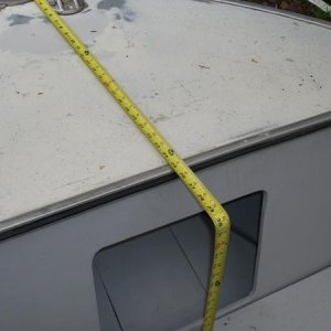

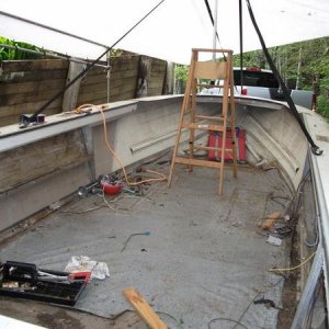

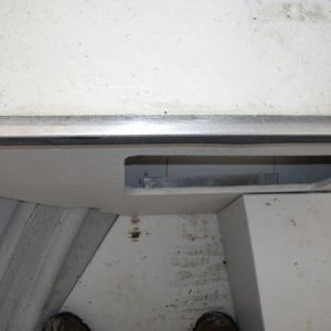

This is view under bow. When I started, my major concern for this area was size to accommodate anchor and rope, not how it would effect the finished
West Coast Willy
May 26, 2010
Port side trim fit.
West Coast Willy
May 26, 2010

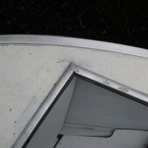

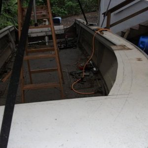

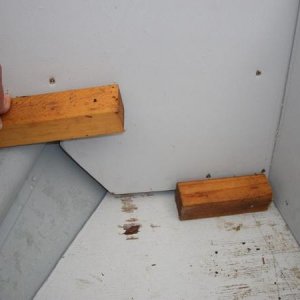

Because of that slant, the interior trim angles won't line up. The sides to match the existing trim had to be at 90 degrees so to solve that problem
West Coast Willy
May 26, 2010
Someone said, experience is knowledge gained too late. Well here it is.. By not leaving the fore deck a little longer, the anchor storage panel slan
West Coast Willy
May 26, 2010
Since I've had no experience with the boat in the water I tried to approximate it's plane in the water by lowering trailer. Gives me a better "eye" o
West Coast Willy
May 26, 2010

The object of this album is to address the various issues with the conversion of the bow area. What I discovered along they way and how to make thing
West Coast Willy
May 25, 2010

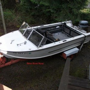

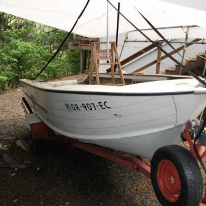

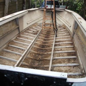

Boat Now
West Coast Willy
May 25, 2010

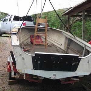

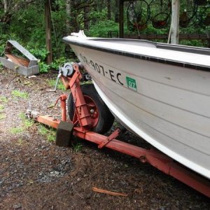

This is the 1970 Starcraft Jupiter I recently purchased. While it's a fine closed bow boat, I propose to turn it into an open boat.
West Coast Willy
May 25, 2010
