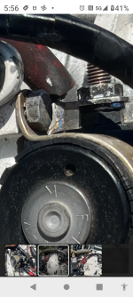

Another possible issue is your starter wire looks awfully close to contacting a ground. Check clearances. Might have been a blessing in disguise that you wired the solenoid wrong...in fact I think maybe the solenoid is in its mount wrong. I have a 70 so I'll go check.

Well, this is an 1987 70 hp rude...it's mounted closer to the starter.
I'd make sure you have adequate clearance.
