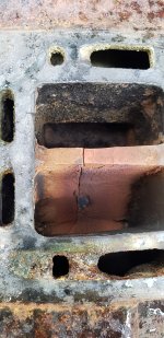

Holy shi** $1200 for the riser? Damn. I’ll snap a pic in a min and post it what I see wrong

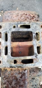

Pics of the exhaust manifold.
I know that's not my main issue. But it's still a problem

52,313
you need a new manifold. its the manifold that is $1200
52,313
No other options?
You may find used.
However used manifolds are like buying used depends......
Remember, boating is an expensive hobby, and $1200 for an aluminum manifold that is no longer available from the manufacturer is a deal

Really beginning to think. Is the crack in the chambers separated a really that big of deal to replace? It’s just the exhaust. It’s not broken and it Leads into 1 chamber at the riser.
52,313
the crack in your exhaust will allow water to come back, run down the exhaust and fill your cylinders.
