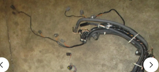

I had pulled my 04 Yamaha L225TURC powerhead to replace an oil pump. Upon reassembly all is connected except the end of the port injector harness, which has two plugs at the end. I am stumped as to where they connect to and can't see any options. I doubt they plug into one another, but look like they would run up to the trim solenoid area. I had taken pics and labeled a few plugs to match up, but this one I did not. I've attached a pic of a harness showing these two plugs going out to the left of pictured, at the end. This is easy stuff, but I'm a little baffled..

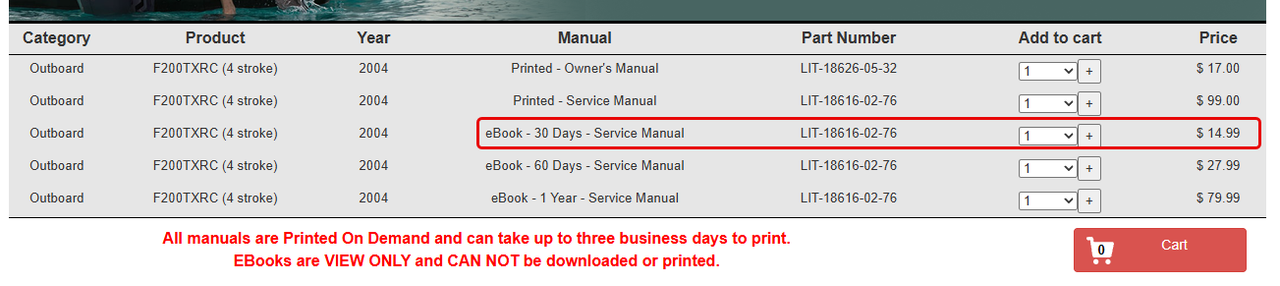

Sounds like you have a need for one at the moment……Factory service manual…$35
