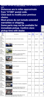

Actual link doesn't work, but a search will.
Prices down there are much less than up here in the rust belt.
