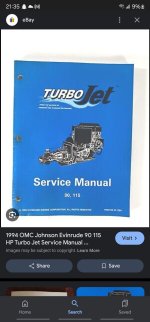

" they are what the turbojet manual recommended"
Turbojet Manual???

My bad, I should have clarified. The turbojet manual is the manual for the engine and jet drive in the boat. It's just a 115 johnson evinrude outboard mounted in the boat on a jet drive. Mines at the shop so I can take a picture of the page that recommends those plugs but this is what the manual looks like, and I'm not sureabout the plugs Everytime I've gone out on the water I havnt thought to pull the plugs and see what's happening with them after it's warm. I can this weekend and let you know.

39,472
The " turbo jet "------Is the V-4 outboard powerhead mounted inside those jet boats 30 years ago.----Marketed for about 4 years at the time.
