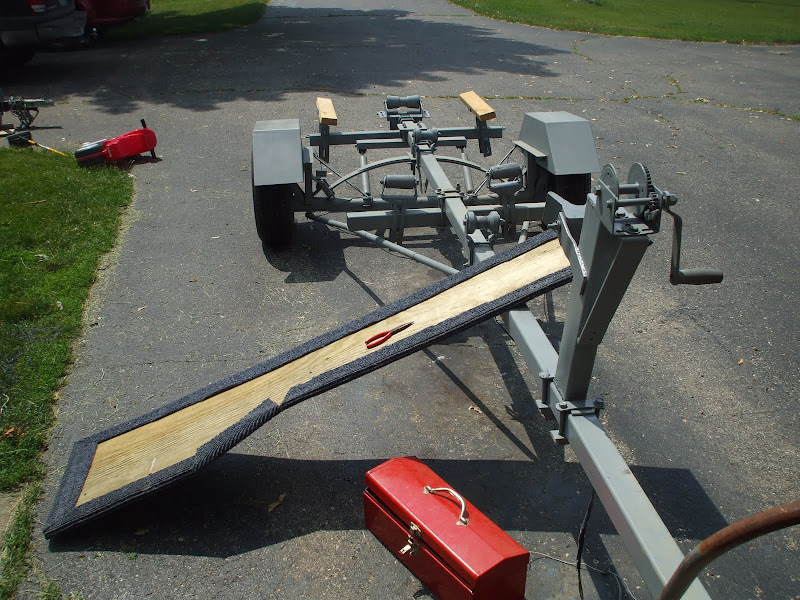

We got rid of the extra vehicle so I now have room to work on both boats in the driveway:D
First order of business is the little boat trailer. That left fender has been jumped on by my boys and it pulled the nut right thru the hole, so it's all wobbly and too close to the tire.
I got it tightened up with new washers and it's all set to go now, easy fix.
The rollers got painted so they won't leave marks on the boat, and then bolted back on. Some roll better than others, maybe some WD-40 will help?
I'm starting to think that I should paint the entire thing, it's awfully bright and blinding in the sun.

Re: 12' 1960s AeroCraft restoration
I was racking my brain to think of how to make bunks without spending a dime...and glanced over at the one remaining carpeted side panel from my Starcraft, perfecto!
Free is pretty budget-friendly...and it's marine grade carpet, not that I would've hesitated to put some shag carpet from the 70s if it were free.;)
In addition, we have the perfect size 2x4s laying around from some shelves that are disassembled. Guess they won't be put back together since I've been pilfering it as a free lumber source for months.:D
I ripped it off the treated plywood angrily, and we'd be finished by now if we had the correct size staples for the gun.:facepalm:
Any other ideas? I do have some leftover vinyl adhesive, but I should probably save that for vinyl.
This homemade trailer cracks me up, it's a real gem!:rolleyes:
Can't wait to launch this thing and catch panfish all day, I miss fishing from boats. It's really not the same from shore or the canoe for some reason.

Yah, that trailer is truly one of a kind, a real beaut buddy!
Yup, I'd be thinking about painting that topside too. I can see Roz or one of the boys sitting on that and end up with a leg omelet, ouch.
It has what I can only explain as an "erector set" mystique surrounding it. And I think it's been around since before erector sets were popular back in the 50s:D
With the early 80s Honda Accord tires it should be ready for duty and hopefully last me a while. We'll see how things go:)
Once I get the bunks done I will be able to set the boat back on the trailer and easily bolt in the transom, adjust the rollers and a few other items. I've also got a bilge drain to install while I have the 5200 handy.
I have not taken many vacation days yet this year, so once the boats are done I will be able to enjoy them and relax hopefully:)

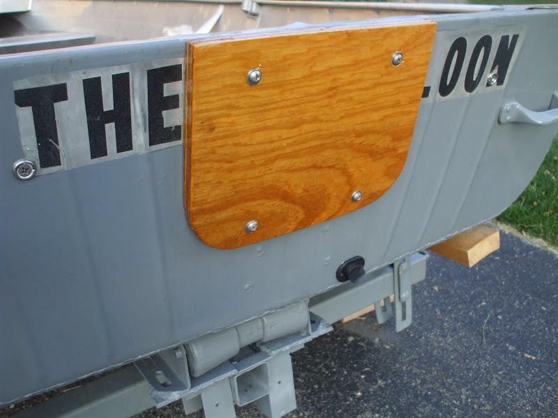

Transom installation went pretty well. I used a good amount of 5200 so I hope it's all sealed up tight.
It has zero flex now, when it used to move a tiny bit. Very happy with it so far.
Here's the bilge drain plug assembly. I went with the plastic one since it's way lighter than the brass.
Seems to be solid and seals very well, I will trim up those screws after the 5200 sets in 24 hours.
I went ahead and dropped in the deck, and hatch frame in place. This still needs to be sanded some, and varnished.

Well we goofed up earlier and forgot 4 washers somehow. Looks much better now:D
Now the next little project. There's a crack on the top of the aluminum there right in the middle.
After seeing jasoutside's trim joint repair with jb weld I think that's what I'll use here.
Then I might rivet in a piece of aluminum angle the full width of the stern right on top.
This would add a bigger lip to catch the little OB clamps in case anything tries to fall in the drink.
