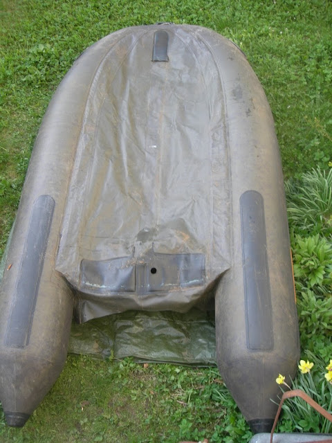

Now to the main problem: The hull material. The material is ftiff and has a lot of cracks in the surface. It also has a hole in it. The keel protector has fallen off along most of the keel, and there is a hole at the edge of the remaining front piece.
The hull PVC glue has also loosened a couple of places along the edge.

As far as the hull PVC goes, I have two options. Either replace it, or glue a new floor on top of the old. I think I will go for the last option. I will glue a new floor in two pieces (right and left) and glue a strip of PVC along the keel overlapping the two halves. The new floor will be glued to the tubes about 2-3inches wider then the old floor. I will also glue PVC to the bottom of the tubes to reinforce them.

Well, it looks like there is more than one boat in the pictures you posted. I can't tell. Anyway, the one will yellow on it has sustained serious sun damage it looks like. I'd worry about it holding up under pressure. The grey boat, tubes, look fairly good though except for the isolated damage you point out. Gluing on the bottom shouldn't be a problem the way you describe it but it'll have to be a quality job to hold up. That transom looks great but it should've been made from marine grade plywood. Even with the expoxy paint, it's going to be very hard to keep water out of the wood fibers altogether. Any moisture in that at all and it's going to delaminate. Take extra time to make sure you seal it very well.

It is all the same boat. The first lipctre in the gallery is the most recent. Some of the ortehr where taken at night in the winter with a flash. It might look worse than it is in those pictures. But of course, it has faded.
