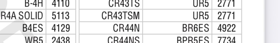

tannergallant123
Jun 21, 2023
46
Okay perfect ya just cross referenced and it looks like the bR6ES is the correct plug equivalent for 73 and below. Thanks. Maybe it's just the right plug and have to adjust the electric choke and the idle air screw.
