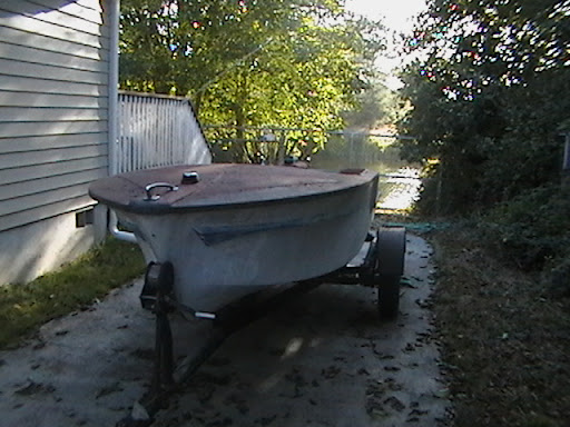

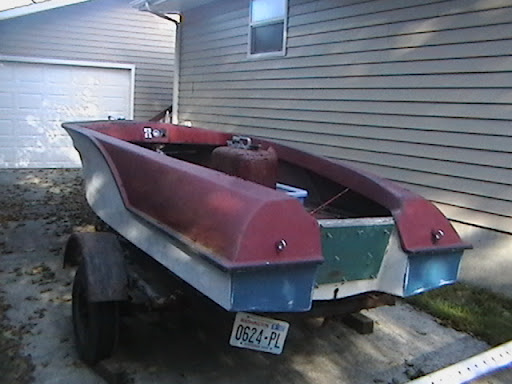

Well, here it is - the long awaited pictures. It's been about a year since I've got a chance to work on it after I moved. It's possibly getting moved into my dad's airplane hangar about 2 miles from my house, providing it can fit under the wing of his Super Cub.

This is my first boat, other than a cedar-strip canoe I built in high school, so also my first stab at any kind of restoration project, including working on my outboard. In an effort to keep myself from getting overwhelmed on this, I'm going to try and break it up into smaller goals that will eventually lead to a nice and safe little sea-worthy boat.
While making up a rough list, I could see alot of questions/problems already surfacing. Here's the short version:
1. New Trailer
2. Transom Replacement
3. Hull Repair
4. Hull Paint ? White - Roll & Tip
5. Interior Layout ? Fuel Tank, Seats, Storage Compartments, Foam, Splashwell, Gauges
6. Topside Paint/Trim ? Red ? Roll & Tip
7. Interior Paint ? Spray-in Bed Liner
8. Rub Rail ? Strip & Polish
9. Windshield
10. Outboard Repair
I know I said I wanted to work on small goals, but I also know a little planning ahead can go a LONG way, so I decided I'd ask some questions before I even get started. I'll skip some for a later time...
4 & 6. Paint - Primary question is a good brand to use, and what I need for hull vs top coats? Boat will be stored on trailer, not in water. Some saltwater use expected.
5. Interior Layout - A few things here: See post below.
7. Once I get the interior finished, I'd like a good non-skid surface on the entire inside rather than carpet. I was thinking of a gray truck bed-liner. Does this work well, or are there other products especially for this purpose?
9. Windshield - I currently have NO windshield. Not even a frame or anything. Any recommendations on where to find something that would fit this boat?? Doesn't have to be an original, just needs to look decent, like it belongs there! There's holes all over the bow where one used to reside. My first thought was finding one on a junk boat somewhere...
10 Outboard Repair - I'll just leave this alone until I get to this point!

Just to clarify a few things. The transom was rotten, It has been removed. All that's there is about 1/4" of glass. I have a template made, and just need to move the boat to a place I can work on it. That brings me to the trailer problem. The old trailer is rusted through. The frame is shot, the bunks are shot, it's not setup right for the boat (the winch IS the bow stop), the tires are shot. The only thing it has going for it is all new wiring and a new winch/strap, which I installed last year. I was looking at a 1200# trailer from EZ Loader, only because that was the smallest trailer that could fit the 53" wide hull of this boat.

It's been a LONG time since I've visited here... I'd like to tell you that my restoration project is completed, or heck, that I've even been working on it. Truth is, life has just been too crazy. After divorce and moving, I'm finally getting settled in again and ready to tear into it this spring.
She still looks just like the pictures in my first post, with a tiny bit of transom work done. I have the rotten transom torn out and a 3/4" plywood template cut and bolted on for now. The plywood is painted and just not good for a fiberglass bond. I'll be taking her on the water as-is with a trolling motor this spring for a fishing trip. After that, I'll take out the template, laminate two 3/4" plywood pieces together for the new transom, get it tabbed in and sealed up good. Then it's just down to stripping, patching and prepping for paint.
I managed to find a new galvanized trailer for $200. Rollers don't fit the boat at all, so I'll probably convert it to bunks. Other than that, it just needs new lights and wiring.
