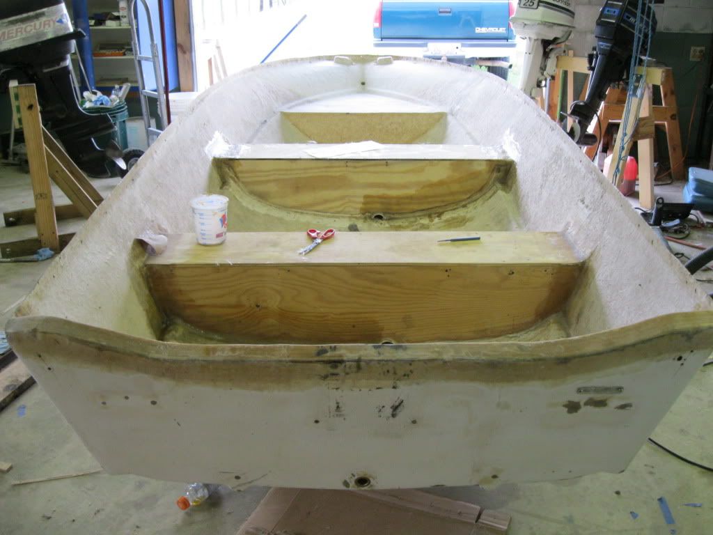

I am currently in the process of fixing up a small boat to take on the local swamp and river and do some duck hunting with in the fall.
I have already replaced the transom and now am working on the two benches
Here is where the questions is.
I cut out the old rotten seats they were 1/4 plywood with a fiberglass coating.
I built new seats with 3/8 plywood and have epoxied them in place and have started to tab them in. I have a few more pieces to tab and i'll be done with that part. For the tabs I am putting down a 8 inch strip of mat; 4 inches up & 4 inches out.
The old seats rotted from the inside out.
Should I completely encapsulate the seats or will tabbing them in be fine? I would of course protect the wood with a quaility paint/primer and then it would get the same color as the inside of the boat.
How can I prevent the seats from rotting from the inside out? Should there be holes in the seats for them to air out?
I painted the insides of the wood before I put them in place.
