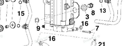

have you done the basics... checked fuel delivery ..filters . that engine seems to have a vapor separtor much like the newer ETEC VST 2005 + .
not shown on some parts diagram is a small conical filter in the fuel route at the bottom of the VST which can and could be plugged with "old" hose residues. VST nipples are brittle DO NOT FORCE $$$$ . you can pull it out with just a large wood screw .. turn & pull it out )
