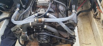

Put on new elbows and checked water flow thru the manifolds and its good (garden hose conn to lower input port and water flows fully out the two ports on top of manifold - it is a dry joint type)
OK so put it all back together and holy **** it still runs hot!
For temporary testing put on clear hoses from thermo housing to elbows and manifolds and took out thermostat (marine mechanic said it is a quick test to eliminate it as a problem). SEE PIC1 "CLEAR HOSES"
Next ran the motor on muffs (good muffs and water flow from tap supply) and saw an amazing thing .... good water flowing to elbows but NO WATER flowing to manifolds.
Next I connected a spigot in to the side of the circ pump and ran a separate hose supply to this. Started motor on muffs and then turned on this direct water feed as well. At last my motor ran at a normal temp no overheating. See dropbox video below (if you get a message to GET THE APP to view it just hit the button saying GO TO WEBSITE or dismiss the pop up message) ...
Now I know that the water out of the T-Piece at the front of the thermo housing passes water flow pretty directly from the leg impeller supply line with the rest going on to the circ pump to go into the block then upwards to exit the thermo housing cap outlets and on to the manifolds.

UPDATE. I think I have solved the problem. Plan was to check the leg impeller and supply line output at 1500rpm before getting the leg off for new impeller and hoses etc. Anyway when I did the 1500rpm test on muffs the impeller supply was great with the offtake hose getting around 10" spurt up height see vid below ...
So I have no worries with my leg impeller output or water feed up to the circ pump. Next was a test of the circ pump via a brass spigot screwed in to the side to check water flow pressure out of the pump. It was pathetic check the vid ...
Almost no excess flow at all out of the circ pump housing via the test hose even allowing for possible flow in to the block. But also no flow into the block from previous testing showing no water flow out of the thermo cap outlets - clear hose allowed good view of this lack of flow you can see this in the vid also.
Now I have prev mentioned I thought the circ pump was 100% as bearings/seals/impeller all checked out BUT when I put the tin back cover on I could not source a gasket so got a quickie gasket sheet from Supercheap Autos - turned out to be quite a thick gasket with stainless sheet inside it was for exhaust gaskets WOOPS. Anyway I cut it out to fit had to use a hammer and chisel as incredibly tough but the real downside may have been the increased clearance between the brass impeller and the chamber backing cover, not sure but its easier to just get a replacement circ pump at this stage for A$120.

1. Just to clarify my boat is a 1985 (not 1885!) Mercruiser/GM 5.7L with an Alpha 1 outdrive. Sorry if I posted in the Mercury MerCruiser Sterndrives & Engines forum. Can someone let me know the best forum category.
2. Several experts have insisted that my problem is due to the leg impeller and/or pieces of this or other debris blocking my cooling passages up to the circulation pump. I have posted a video image of the strong water delivery around 10" spurting vertically from the leg supply via a hose take off from this line SEE IMAGE BELOW so I do not have any doubts that my impeller and supply lines are in good shape. Local marine mech actually did full new impeller kit inc housing about 6 months ago. Always changed annually prior to that. No dry running or sand ingestion etc since.
3. Same mechanic told me via phone to take out the (newly replaced) thermostat as a test only to eliminate that as the problem IE no water flow down to exh manifolds. I later did a slow boil of the new thermostat and it started to open at 150F and fully open at 160F so I plan to put it back in. Funny the t-stat was rated at 142F and supplied x dealership who matched it to my serial# which they say is a warm manifold system. Could be my wife's cooking thermometer is a bit off, but I have never complained!
4. BTW he just text'd me last nite and said it could be similar ro another mystery case he had encountered in his 40 years experience, turned out that was caused by rust blockages in the actual thermostat housing causing ALL the water to flow off to the risers and none to the circ pump and block. Please no LAUGHING OUT LOUD here I am going to check it out and if not true then off to buy a new circ pump. Or is it even possible that the block could have "blockages" hope that's not why they call it the block?
